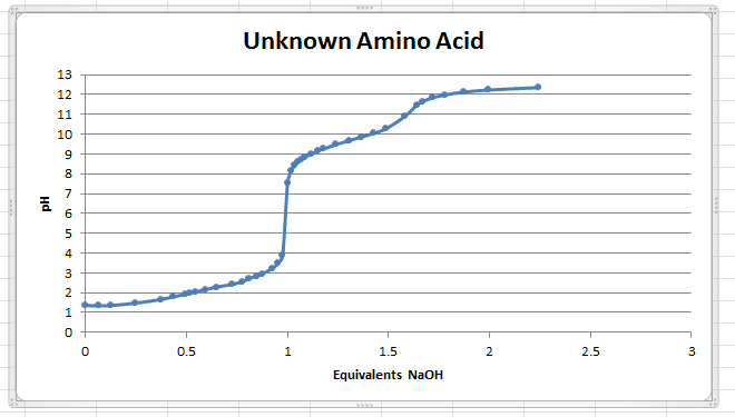

To elaborate, the 0.2 N HCl information goes along with my titration curve below:
As far as I know, the actual amino acid unknown solution was prepared by dissolving 4.5g of the unknown amino acid in 300mL of 0.2 N HCl.
The titration, however, only used 20 mL of the solution.
Currently, I'm at a loss, because the technically one equivalent of OH should be used to titrate one of the ionizable groups of the amino acid. At 2 equivalents, however, there doesn't appear to be any rise in pH. I'm beginning to wonder if the amino acid above is actually triprotic.
Yes I think I know what you mean. The opposite of what you say :biggrin: - there is a very steep rise in pH there.
That would normally be a good question, however both what you are told and your experimental data say diprotic.
Borek said:
If so, you titrated 20 mL of 0.2 N HCl and 20/300*4.5 g of the amino acid. But 20/300*4.5 is 0.3 g, not 0.432 g. Plus, you have not used 7.39 mmol of NaOH to neutralize the aminoacid, but 7.39-20*0.2=3.39 mmol.
Perhaps - if the question is made up - information about initial pH is simply wrong and put there without a second thought. Generally speaking valine looks reasonable, it just doesn't fit rest of the information.
I don't agree. There are two inflection points. The first one is the HCl titration at ~1 "Equivalents NaOH", whatever that means in this case. Is it 40 grams? I don't think so. The second inflection point is the ammonium proton. The difference between these two peaks should be the amount of base corresponding to the monoamine monocarboxylic acid, right?
What is presented isn't data. It is partially-reduced data without an explanation. Raw data would be presented as pH vs volume. Equivalents of base means nothing without an understanding of the underlying assumptions.
What is meant by "Equivalents NaOH"?

This is a monoprotic amino acid. The amount of base used is that amount between the inflection points NOT the amount required to go from either pH 0.8 to 12 or from pH 7 to 12. pH 12 is an arbitrary endpoint for this experiment designed only to fully describe the inflection point at pH 11. You still need to determine mmol of NaOH used between the inflection points.
