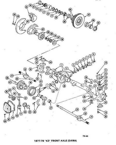

Here is a solid live axle:
The axle (23) pushes on the bearing (20), the bearing (20) pushes on the differential casing which is actually part of the suspension.

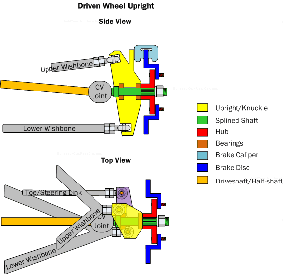

Here is one for an independent suspension:
The axle (green) pushes on the bearings (orange), the bearings (orange) push the upright (yellow) that is part of the suspension.
Here is a more complex one for a front live axle that incorporate steering and a locking/unlocking feature:
The "rotating" axle (21) goes through the "fixed" axle (60) and connects to the disc brake (67) via the locking/unlocking mechanism (70-76). The disc brake (67) pushes on the bearings (66 & 69) which in turn push on the "fixed" axle (60). The "fixed" axle is solidly linked to the differential casing and steering mechanism.
