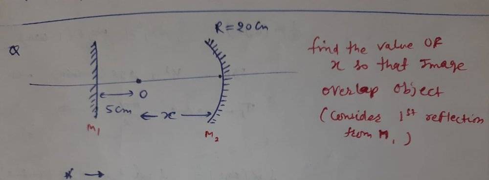

Handwritten optics diagram: plane mirror M1 on the left, object O 5 cm to its right, concave mirror M2 with R = 20 cm on the right, separated by distance x; text asks for x so the image overlaps the object.

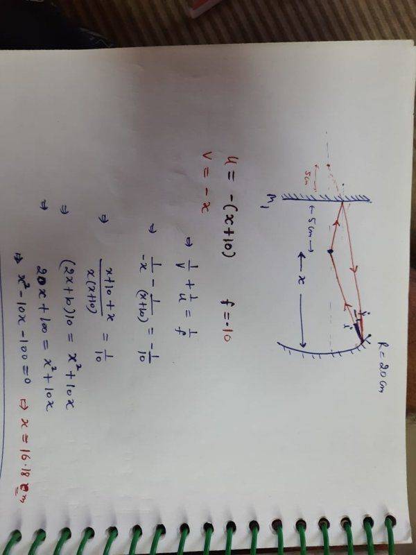

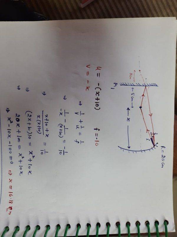

Is this solution is possible if not then why?
  • Handwritten mirror ray diagram on lined paper, rotated, showing a concave mirror of radius R = 20 cm with a vertical object at distance x and a 5 cm offset, plus working: u = -(x+10), v = -x, f = -10, 1/v + 1/u = 1/f, and the algebra leading to x^2 - 10x - 100 = 0, x ≈ 16.18.
I notice the sign isn’t consistent with all the other signs. You didn’t do the signs the way I would have, but I think the way you did them you would have to still write f as positive.
Normally the sign conventions are relative to the actual direction of the light. If the object is on the same side of the optic as the light is coming from the object is real and the sign is positive. If the image is on the side of the optic the light is going toward, the image is real and the sign is positive. If the optic is focusing the focal length is positive. In that convention x is positive, x+10 is positive, and f is positive.
Ha! That feels like a trick question. All right, I’ll bite. I believe there is only one. In fact, I believe it even only works on axis as the virtual source and the real image move in opposite directions when you move the real source.
Like after reflecting concave mirror if the ray retrace its paththen also we can get a value of x that is also a probability.
Well, that does put the image on top of the object, and that is all the question explicitly asks. So I guess that is a valid answer.
However you should note that those are fundamentally different. In the solution using both mirrors the light not only returns to the object, but it is also traveling in the original direction. If it can pass through the object it will happily go around again and again. This constitutes a resonator. You can stick gain in where the source is and make a laser.
Still my doubt is that out of these two which is correct. If anyone solution is wrong then why ? Out of this.
