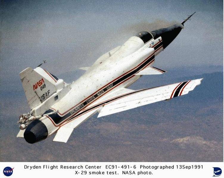

Do you remember when jets had wings swept back? That was done for better stability but at a cost in speed. Now, with military jets flown mainly by computers, some instability is acceptable for better performance and wings are swept forward.
Well, forward wingsweep is still very much at a NASA technology demonstrator stage. A lot of the X-29 data is still classified. But you are correct about stability augmentation systems (SAS).
I don't know of any forward swept wing aircraft in production.
