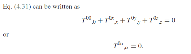

I‘m reading the chapter 4 《Perfect fluids in special relativity》of《A First Course in General Relativity》.In the process of deriving conservation of energy-momentum,it said:##\frac {\partial T^0{^0}} {\partial t}=-\frac {\partial T^0{^x}}{\partial x}-\frac {\partial T^0{^y}}{\partial y}-\frac {\partial T^0{^z}}{\partial z}####\;##then it writes:##T^0{^0}{_0}+T^0{^x}{_x}+T^0{^y}{_y}+T^0{^z}{_z}=0##...I wonder why the partial derivative is represented by covariant index?
Are you sure it doesn't have a comma before each lower index? That comma indicates partial derivative, making it different than a tensor index. In this older notation, a semicolon would indicate a covariant derivative.
Likes dextercioby, GR191511 and malawi_glenn
There is a comma indeed.
This notation is introduced in the book (2nd edition) in equation (3.19)
Because the derivative operator acts like a covector, i.e., a thingie with a lower index. For example, you can contract the derivative operator with a vector to get a number (this number is usually called the "divergence" of the vector).

Incidentally, Carroll's lecture notes state this notation and then go on to say how easy it is to make exactly the mistake OP did, especially in handwriting. That's why he largely uses ##\partial_0T^{00}## in preference to ##T^{00}{}_{,0}##.
Likes vanhees71, Dale, GR191511 and 1 other person
Yes, I've always preferred that as well, even though my favorite GR textbook, MTW, insists on using commas and semicolons instead of partials and nablas. I've never really understood why: it's not as though partials and nablas are scarce resources. :wink:
