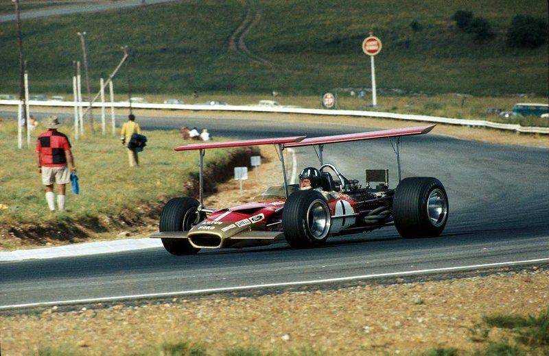

The main reason you do not see active aero devices ( spoilers, splitters etc) is the governing rules of the sanctioning organization. Their reasoning is cost cutting as a fixed piece of fiber galss or carbon fiber is cheaper than one with an activating mechanism. In Nascar they really clamp down on any adjustments as a safety consideration. On super speedways they know exactly the aero down force and can limit "safe speed" to a point. In F1 if you give them an inch they will take 2 miles. Just look back to the ridiculous twin wing things that ran in the 1970s. Racing at the local level is sanctioned to keep some kind of cost savings. Regulations limit you to a hard " spec tire" or limit the number of new tires you can race in anyone event to cut cost..hahahah..right. In the Saturday night bull rings that week end racer run, you are limited to fixed spoilers at set height, width and in some cases, angles. Material is dictated as well. Clear plastic so drivers following the lead car can see the lead cars driver when he signals signals.
We all know active aero is the hot ticket but its a rules thing.
