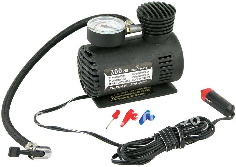

Instead of using fan, can i just use a compressor ? but how do I covert the compressor's pressure to m/s ??
Something like this ??
But the output of this kind of compressor is so small
only few inch @@
I'm not sure if the compressor gets enough air flow for a reasonable wind tunnel. It is possible to get 20m/s easily with a small pipe, however.

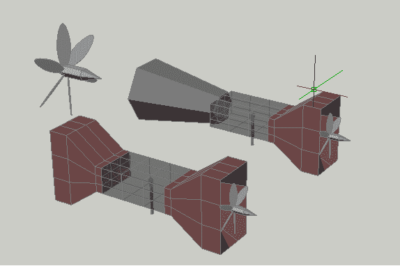

Anyway I'd comeup with two design. which is better?

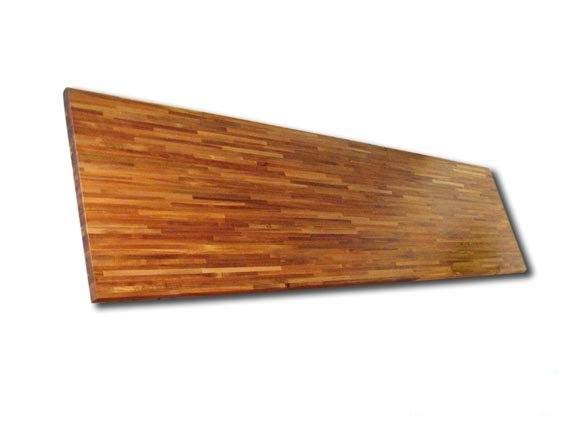

I am thinking of it , the chocolate part is made up of wood?
will wood eventually works?(FINE wood boards)
something like this.
As if for the test part, it should be made up of acrylic(Perspex)
for the fan.

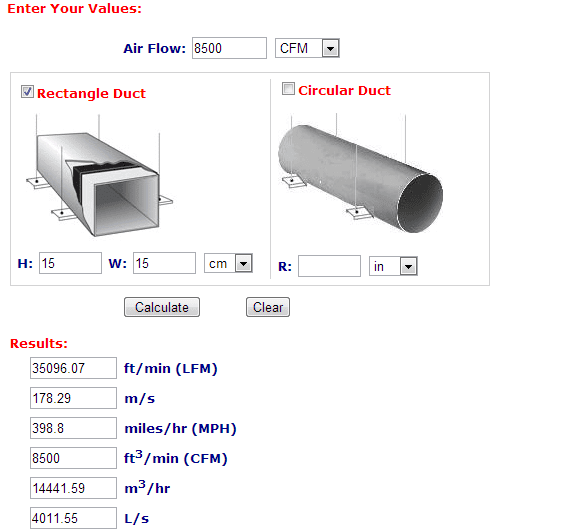

With Air Delivery CFM 8,100-9,500
And The Volume of test area of 15cm x 15cm x15cm
I'll get the max of 70m/s?
is this for real?
By using the converter
Your air delivery value requires the full cross-section of the fan - with your wind tunnel design, air flow will be reduced (as air pressure builds up behind the fan).
