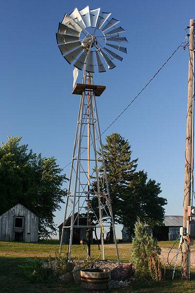

The "old style" wind turbines like the one below were not very efficient, but they didn't need to be efficient to do what they were used for.
Yeah, now that's what I'm talkin bout.

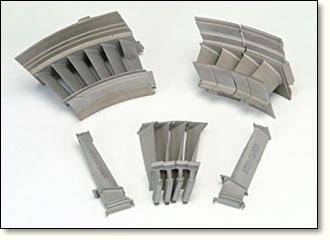

Ok, more blades are less efficient. When I look at turbofan jet engines, the bypass fan, compressor stages, and turbine stages look like the above (well a little more sophisticated than "green acres"). Should they be reduced to 3 blades as well?

A turbine with many blades rotates slowly, but with a high torque, that is why they are used on farms to reliably pump small quantities of water.

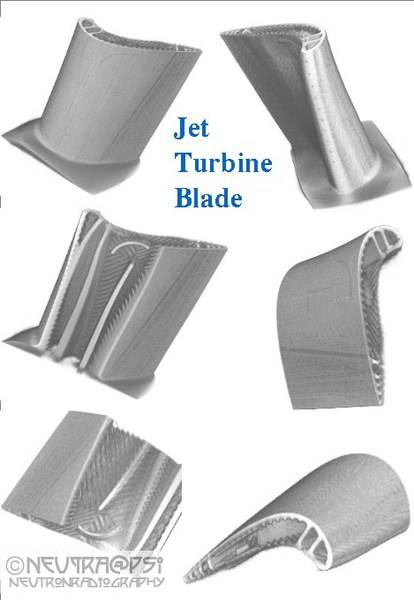

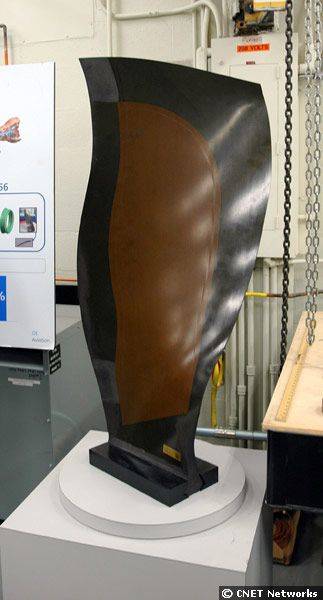

No, for several reasons. First the blades in a jet engine are inside a casing. That makes a big difference to the flow pattern, because all the air is forced to go through the blades. Second, a jet engine turbine is working under very different conditions from a wind turbine. The inlet gas is at high pressure and expands as it flows through the turbine. In a wind turbine, there is no pressure change between the air in front and behind the turbine. And finally, jet engine compressors and turbines are not just "mirror images" of each other, the blade designs in compressors and turbines look very different.
The reason why all the fans on large diameter jet engines have about 24 blades (plus or minus about 2) is because that is the optimum number for what they are designed to do. It's not just a coincidence that three different engine manufacturers all use fans with similar numbers of blades.
If you look the shapes of a jet engine fan blade and assorted turbine blades, they are obviously completely different from modern wind turbine blades, and the jet engine fan and turbine blades are very different from each other.
