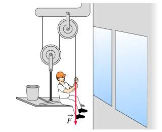

A window washer of mass M is sitting on a platform suspended by a system of cables and pulleys as shown . He is pulling on the cable with a force of magnitude F. The cables and pulleys are ideal (massless and frictionless), and the platform has negligible mass.Find the magnitude of the minimum force F that allows the window washer to move upward.
Express your answer in terms of the mass M and the magnitude of the acceleration due to gravity g.
Newton's second Law
For the person: Ma = F + T -Mg where T is the tension in the cable holding the platform and F is the force of the rope on the washer.
Then from the lower washer T = 2T[tex]_{1}[/tex], where T[tex]_{1}[/tex] is the tension in the rope
So Ma = F + 2T[tex]_{1}[/tex] - Mg
The block is about to move so Ma = 0 and I think T[tex]_{1}[/tex]=F so then
0 = 3F - Mg
I am not sure about this though
Looks good to me. :smile:
I would first clarify the setup of the problem. It seems that the window washer is pulling on a rope to move the platform upward, and there is another rope attached to the platform that is also being pulled. The tension in this second rope is equal to twice the tension in the first rope. Additionally, the platform has negligible mass and the cables and pulleys are ideal.
Next, I would use Newton's second law to analyze the forces acting on the window washer. The only forces acting on the washer are the force of the rope he is pulling (F), the tension in the rope holding the platform (T), and the force of gravity (Mg). Therefore, the equation would be Ma = F + T - Mg, where M is the mass of the washer and a is the acceleration.
Since we are looking for the minimum force that allows the washer to move upward, we can assume that the washer is on the verge of moving, meaning that the acceleration is zero. Therefore, the equation simplifies to 0 = F + T - Mg.
We know that the tension in the second rope is equal to twice the tension in the first rope, so we can substitute 2T for T in the equation. This gives us 0 = F + 2T - Mg.
Since the platform has negligible mass, the tension in the first rope (T) can be assumed to be equal to the force of the rope on the washer (F). This means that T = F.
Substituting this into the equation, we get 0 = 3F - Mg. Solving for F, we get F = Mg/3.
Therefore, the minimum force that allows the window washer to move upward is Mg/3, where M is the mass of the washer and g is the magnitude of the acceleration due to gravity.
