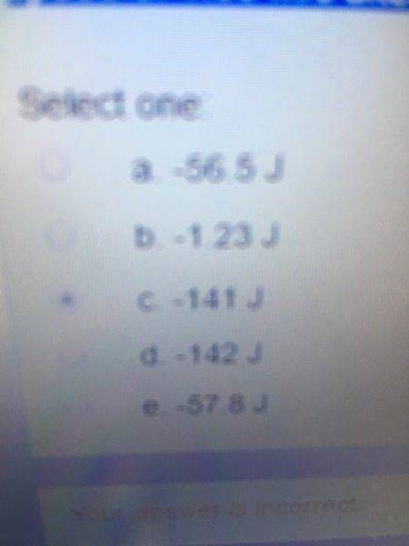

the first pic are the possible answer choices
