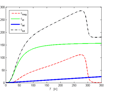

This magnet is used for magnetic refrigeration where a magnetocaloric material is heated up to produce cold. However, a 1T field produces about ΔT = 2.5 K, which means the energy for enthalpy change is about Q = m*cp*ΔT = (0.25kg)(240 J/kg-K)(2.5) = 250 J. So it makes no sense that I can have 250J of energy from a 10J field... Yes I didn't take into account the efficiencies and all losses, but the order of magnitude is just way to much.

To answer your question, I use the size of the minimum possible size of sample as the volume (vol = m/ρ=200g/7900kg/m3=2.5 e-5 m3) and cp is the typical value at 293K and 1 T (see attach for the curve).
