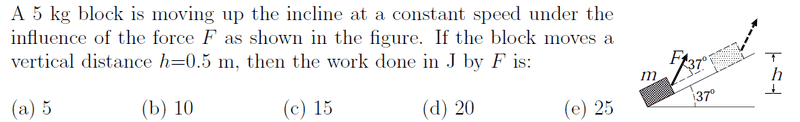

W = F d
F = ma
Constant Speed ==> a = 0 ==> Net Force = 0 ==> F cos 37 = mg sin 37 ==> F = 37.6 N
sin 37 = h/d ==> 6/10 = 0.5/d ==> d = 5/6
W = F d = 5/6 * 37.6 = 31.3 N [Not In Choices] - Any Help?
Perhaps it would be better to consider the work done as the change in potential energy and approach it that way.
yup! W = mgh = 5 * 10 * 0.5 = 25 J
In my previous attempt, my mistake was not writing cos 37 in finding the work

The original problem had constant speed. I think you will find that this one doesn't.
Your initial method (after correcting by including cos(37°) in that case) should work here.
How "constant speed" differ?
KE is constant.
Sorry, but how is that relevant?
The way I think of the work done is final energy - initial energy
In final energy I have potential energy (mgh) only
In initial energy there is nothing in this case
So,
W = mgh
Where is my point of confusion?
The final energy will not be only in the form of potential energy.

We don't know the final kinetic energy. Since there is an external unbalanced force there is an acceleration so the initial KE cannot be taken as the final KE. So to apply conservation of energy, we don't have enough data.
OK Thanks, what about if it is constant speed. Initially velocity = 0 but final is not 0. So how we only used W = change in potential energy, without considering hte KE

That is correct for #1 (constant velocity) but not #4 (constant force)
In #4 the block is accelerating so the final KE is not the same as the initial KE.
You can use conservation of energy to solve this but you would need to calculate the final velocity.
It is easier to use work = force * displacement.
Thanks, but why you said it is correct for #1 ?
It is constant velocity so we still have velocity in Ef but we don't have it in Ei (before applying the force)
Guys, I understand that in [constant force] we can't use principle of energy without find final KE.
But my problem is why we could use it in [constant speed], as we still have final KE

W = ΔE :
(Work done by an external force) = Change in total mechanical energy.
also E = KE + PE
So W = ΔKE + ΔPE​
In the first problem:
The velocity was constant, so the Kinetic Energy didn't change. Therefore, the work done by force, F, was equal to the change in Potential Energy.
When you did the problem using the definition of Work, you had to find the amount of force which produced zero acceleration. -- It was just enough to counteract gravity.​
In the second problem:
You are given the force. It's unlikely that it's the exact amount to counteract gravity, so the acceleration will not be zero. There will be a change in kinetic energy as well as in potential energy. You can still get an answer from energy considerations, but it will be quite a bit more involved than simply calculating the Work directly.​

But isn't the speed constant DURING the action of the force NOT before? So before (E initial) there was no movement i.e. KEi = 0 ?
Sarah00 said:
Brilliant answer. Thanks!
That issue is not addressed in the problem. (You're referring to the first problem, right?)
It simply says that the block is moving up the incline at a constant speed.
Aha now I am happy enough..
Same kinetic energy before and after so they cancel each other

Problem 1
the driving force (f) = the opposing gravitational force
the work done = f * distance traveled up the incline
Problem 2
The change in KE, the gain in PE and the work done all have the same value

That's not correct for problem 2.
Your right, the work done = ( gain in KE + gain in PE ), according to my calcs the work done = 111.81 Joules
