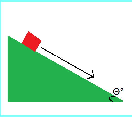

Say we have a friction-less inclined plane in the shape of a right triangle, sloping downward to the right. The angle above the horizontal axis is inconsequential for these specific purposes aside from the fact that we know it is inclined above said axis.
We then have a block sliding down (to the right) the plane. My question is about the work done on the block by the incline plane and gravity.
Is the work done by the inclined place on the block considered to be positive, negative, or zero? I think it is zero as what would be considered the normal force has a direction perpendicular to the movement of the block.
I am also hung up on the same question regarding the work done by gravity. It would make sense to think the work by gravity would be positive as that is what moves the block down the inclined plane without outside forces having acted upon it. I just wanted to verify these if anyone could possibly clear things up a bit.
Thanks in advance.

Hello TheNotoriousWM. Welcome to PF !
You are correct on both accounts.

Now, let's consider the work done by the inclined plane. As you correctly stated, the normal force (perpendicular to the movement of the block) does not do any work on the block. This is because the direction of the force is perpendicular to the displacement of the block, and work is only done when the force and displacement are in the same direction. Therefore, the work done by the inclined plane on the block is zero.
Next, let's look at the work done by gravity. Gravity is the force that is causing the block to slide down the inclined plane. As the block moves in the direction of the force, work is being done on the block. Therefore, the work done by gravity is positive.
In summary, the work done by the inclined plane on the block is zero, while the work done by gravity on the block is positive. I hope this helps to clarify any confusion you may have had. Keep exploring and asking questions, that's what being a scientist is all about!
