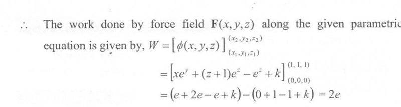

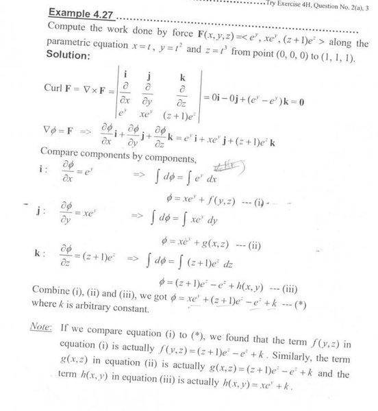

for the work done θ , after combining all three , the work done should be = 2x(e^y) + (z+1)(e^z) - (e^z) + k , am i right ?
why the author stated it is x(e^y) + (z+1)(e^z) - (e^z) + k ?
There's x(e^y) in equation (i) and (ii)
θ= (x)(e^y) + f(y,z) + (x)(e^y) + g(x,z) + (z+1)(e^z) - (e^z) + h(x,y )
= 2(x)(e^y) + (z+1)(e^z) - (e^z) + k
No, the author is right. You shouldn't simply add the RHS of the equations. The expressions which are common don't need to be added. In your example, if you had ##2xe^y## ( like you thought), you wouldn't get ## \frac {\partial \phi}{\partial x} = e^y## and ## \frac {\partial \phi}{\partial y}= xe^y##

I would never have solved it this way. I would have expressed everything in terms of t.
Exactly, I too would have done the same.
