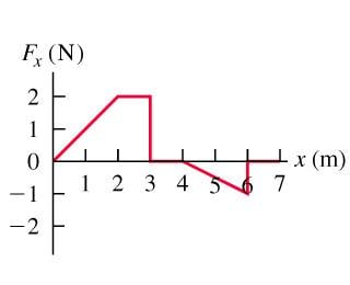

    A force is applied to a 2.5kg- radio-controlled model car parallel to the x-axis as it moves along a straight track. The -component of the force varies with the x-coordinate of the car as shown in the figure .Suppose the model car is initially at rest at x=0 and [tex]\vec{F}[/tex] is the net force acting on it.
    Use the work-energy theorem to find the speed of the car at =3.0.

    3. The attempt at a solution
    (2N)(3m) = 1/2(2.5kg)v^2
    6J = 1/2(2.5kg)v^2
    12J = 2.5kgv^2
    12J/2.5kg = v^2
    [tex]\sqrt{12J/2.5kg}[/tex] = v
    v = 2.2m/s wrong
    another try
    W = [tex]\int[/tex]Fx = x^2/2 from x=0 to x = 3
    so 9/2 = 1/2(2.5kg)v^2
    [tex]\sqrt{9/2.5}[/tex] = v, v= 1.9 wrong
    I keep rearranging all the formulas with the information they've given me and still nothing, any help is greatly appreciated.

    In your first attempt at the solution, re-examine the definition of Work.
    Does 2N*3m accurately represent the work done?
    Remember, Work is not simply F*x rather:
    [tex]W=\int_{x_1}^{x_2} F\cdot dx[/tex]
    What does the integral represent on the curve? Check your math on the second try.

    I think to hammer home the point he was trying to make, look at that integral, carefully
    In the case where F is not a function of x and is in the same direction as dx(like it is in this problem so don't worry about that), it's a constant and comes out of the integral, so you're just integrating 1*dx, which is x, so you get the familiar F*x
    HOWEVER, in this case you actually have a F that varies with position. Oh noes an integral you must solve? Not necessarily, remember, what IS an integral? You have a function F(x), if I integrate between two points what is that result?
    So basically 2*3 would give you the work done if the force had been 2 newtons the entire time. But it's not

    integrals represent the area under a curve, the first curve being from x=0 to x=2, and then from 2 to 3.
    I'm thinking the functions are wrong, the first function from x=0 to x=2 would just be x, so the first integral would be
    F(integral from x=0 to x=2) xdx = x^2/2 from x = 0 to x =2 and it would be 2(2^2/2) = 4
    and the other integral there is no function so
    F (integral from x=2 to x=3) dx = x from x = 2 to x =3 and it would be 2(3-2) = 2(1) = 2
    2+4 = 6.
    I'm not sure how to use the force as a changing force and not a constant one...
  11. Feb 19, 2008 #10
    Oh soooo close
    Exactly like you did it except I have no idea why you multiplied the first integral by 2 randomly.
    It was exactly like you said, integral of x*dx from 0 to 2, which ends up being 4/2=2
    For the second one you have the integral of 2*dx, so there's no function, you're correct, the force is just a constant, 2. So it's 2*integral(dx) from 2 to 3 which you found correctly as 2
    2+2=4
    Now for useful skill #394609 you're about to learn.
    An integral is just an area under a curve, from x=0 to x=3 in that picture you have a triangle and a rectangle. The area of the triangle is just 1/2*base*height, so 2*2/2=2, and the rectangle is just 1*2=2. 2+2=4

    You have the right idea. However, your integration on the first section is incorrect.
    [tex] W_{12}=\int_0^2 xdx=\frac{1}{2}x^2\mid_{0}^{2}=\frac{4}{2}=2[/tex]

    anyway, thanks a bunch on part a), but part B, which is the velocity at x=4, has me a little stumped, because I'm assuming there's no work because it went down to 0, but obviously it moved so it has to have some velocity.
    I tried:
    K2 = K1 + W1 = 4.05 + 4 = 8.05
    1/2mv^2 = 8.05
    mv^2 = 16.1
    v^2 = 6.44
    v = 2.5m/s but I got it wrong, anyone?
  16. Feb 20, 2008 #15
    You're right that no work was done to it while the force was zero
    You already found the speed at x=3 for part a, right?
    So here you have something moving along at some speed, then you...do nothing to it, and wanna know how fast it's going a meter later...
  17. Feb 20, 2008 #16
    I'm freakin' stupid, it's the same thing, lol.
    now part C, I'm assuming they're 2 integrals, one from x=4 to x =6 and one from x=6 to x=7; with force -1 acting on the first integral and maybe 0 force acting on the second one, or could I just use the triangle formula again with 1/2*base*height = 1/2(-1)2 = -1?
