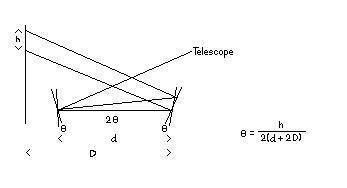

i've derived the other formulae
but I'm still stuck on this one, Koenig's Aparatus formula
here's a picture of it with the formula need to derive into
theta = h / [2(d+2D)]
