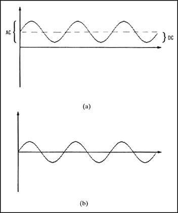

QUESTION 3
Given a sinosoidal signal V(t) = 2.2 sin 314t. This signal rides on a direct current whose value is 12V. You may say that the average voltage of the signal is 12√2 V
ANSWER
This one is a bit confusing to me. I want to say "NO, for a full rectified wave, the average value would be 2U(max)/pi"

Q3). Try sketching the composite waveform, and graphically demonstrate its average. (Rectified? You didn't say that the question uses the word "rectified". Better be clear about that minor detail. :smile: )
To be honest this question is a bit confusing. It's supposedly a "sinosoidal wave", but it "rides" on a direct current!? What does that mean? Which signal am I supposed to draw? My best guess is that they mean a half-rectified waveform

By 3 rd question diagram do you mean the waveform shown in the attachment below ?
You draw a sinewave symmetrical about an axis, as usual. But instead of that axis being 0 volts, you label it 12 volts and redraw your 0 volt line further down the page. :smile:
Hmm...how do I know how further down to draw that zero?
Can you draw a graph of a "direct current whose value is 12V"?
(Note that this is not a sinusoid.)
And can you also draw a graph of a "sinosoidal signal V(t) = 2.2 sin 314t".
What is its amplitude?
(You're allowed to add little drawings of flowers and such. :wink:)
Can you finally draw a graph that sums both graphs?
What is its average?
What is the average of a constant value current/voltage? What is the average of a sinusoidal without any offset? A rectified sine is not sinusoidal anymore. Averages are additive.
If your scale is 1 cm = 1 volt, about 12 cm down. :wink:
(You're allowed to add little drawings of flowers and such. )
One step at a time :) Is this alright? ->
http://img543.imageshack.us/img543/272/avgm.jpg
(Ahh...forgot flower!)
Alright, I want to see if my idea for a graph is correct so far so I'll wait with it :)

why is there a rectified waveform ?
Because they say it's "DC" yet it originates from AC...so a rectified AC would look like that

In your question there was never a "rectifier" word used i guess ? it was only written that ac signal rides over dc signal ?

Mmmh, it means that the 2 graphs are summed.
It's also called superimposed.
It means that if the sinusoid is zero, the combined graph is 12 V.
And when the sinusoid takes on its maximum value (which one is that?), that the combined graph is 12 V plus this maximum value.
I would assume the max value is 12√2, but I'm not sure in anything anymore.
Is lazyaditya's graph accurate? You'll have to excuse me this issue is somewhat confusing to me.
I take it you mean this one?
Yes, that is what happens.
The sinusoidal signal given in (b), which is AC, rides on top of a direct current signal (DC), resulting in the graph given in (a).
Did you write what you meant to, here?
What you have is basically 12V DC, but it isn't absolutely smooth. There is a small amount of ripple on it, so the DC fluctuates between, for example, 11V and 13V. And that fluctuation is smooth and regular, like a sine wave. (The 11V and 13V levels I mentioned are not precisely the levels in your case in point. And I don't like using the word "DC" like I have here, but it will have to do.)
To be honest I've a bit lost myself. Let me try to refind the string here...
We have a DC wave whose avg (or rms?) is 12 volts...and since the sinusoinal one rides on it it means...
But I'm not sure of anything anymore..
Riding on it, does not mean the entire graph is put on top.
It means you should "add" the signals.
Are we talking about one of the formulas here?
Yes.
So what's the maximum voltage of the "sinusoidal signal V(t) = 2.2 sin 314t"?
Can you perhaps draw a graph of it?
And what would be its average (not to be confused with the RMS)?
  • #32
Alright, so I'll use the formula (after next quote)..
Yes.
Before I draw the graph...is this the correct calculation?
