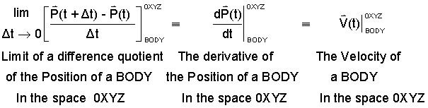

To press the idea "at its basis" means to inspect the "very least change of position." But as the change of position becomes smaller, so also does the increment of time, Δ t. But the quotient, how does it change, what does it become as its denominator, Δ t vanishes. The vanishment of Δ t is written as - (Δt → 0). This discussion about of imaginary mathematical idea is called a "limiting process" or "taking the limit." The idea can be expressed only implicitly, meaning as "an idea."
To think of something, to suppose something exists at an instant on Earth so short as to be "zero length in time:" such is certainly an abstract idea. Newton called this abstract idea related to physical reality of a BODY, the velocity V(t*) of the BODY at time t = t*. Each of the three notations below is identically and completely equal to the other two. All three notations mean velocity of a BODY in 0XYZ-space.
A211 Mom 05
(5)5
