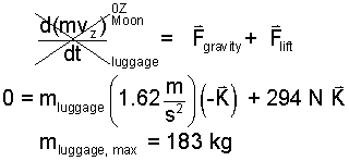

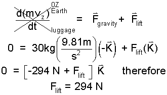

On Earth an astronaut can apply a certain "lifting force." The astronaut can also apply that magnitude of lifting force on the moon. The force to support 30 kilograms on Earth is determined from Newton's 2'nd Law.
To simply hold something while motionless is a case of uniform motion with the velocity being constant (and zero). The event of this example is a change of the source of gravitational force from being the Earth then later, the moon. (You should solve this problem with EE units also).
Calculation below shows, the force to support 30 kilograms on the Earth surface is 294 Newtons.
On the moon, the astronaut can again apply this force to unload the capsule. Hence the mass that might be unloaded is 183 kilograms.
Notice the two events have separate inertial reference points. This different is not a problem since there is no motion (relative to the source of gravity) in either case.
