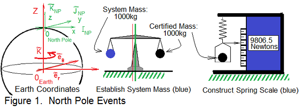

A "certified mass" is used to calibrated a spring scale at the North Pole.
Later, at the Equator, the spring scale shows a discrepancy using the
same mass."
North Pole Event:  The discussion below is a comparison of two "weighing events" on Earth. Each weighing by the same spring scale is assumed to be in inertial coordinates. To keep things clear a first step, Figure 1 is a setup.
North Pole Beam Spring 01
In Figure 1: Earth is represented as a rotating "upright" sphere. Earth Coordinates rotate with Earth but the "North Pole" coordinate set does not to rotate. Establish Mass: System mass is established using a standard (1000kg) and a beam balance. Establish Force Scale: At the North Pole, a spring scale is calibrated while supporting the system mass.

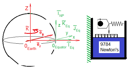

Equator Event: Figure 2(a) depicts Earth with coordinates at the Earth center and Equator (Earth surface)coordinates. Figure 2(b) shows the (NP calibrated) spring scale supporting the system mass, 1000kg. The scale reading is 9874 Newtons.

1) Location ~ North Pole (assume fixed coordinates):  A mass, "certified 1000kg," is used to establish system mass of 1000kg. Next, our mass, (system) is used to calibrate a spring scale. A mark, 9,810 Newtons is made for support of the a Spring Scale.
2) Location ~ Equator (assume fixed coordinates): The system (mass) has been moved to Earth's equator. The spring scale is set up. is set upAt the North Pole, a mass,

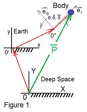

About Coordinates:  By way of simplification (with no harm to our results) we picture spherical Earth rotating in an upright alignment with the North Pole uppermost. Figure 1. shows Earth at an instant in time. Three coordinate references are drawn.
Earth-Rotating:  The origin of this orthogonal set is located at the center of Earth. The unit vector, K, coincides with the axis of rotation. The time-dependent unit vectors, er(t) and eθ(t) rotate in a plane of the Equator. Rotation of the pair, seen from above, is "counter-clockwise." Coordinate References 300px

Fig 1 280pxbegin with a rather elaborate set of coordinate systems all in the same plane as shown - Fig 1.
Coordinates 0XY:  Somewhere beyond the solar system, beyond the Milky way, we assume there is a location 0 that moves with constant (possibly the constant zero) velocity. Further we suppose a set of orthogonal coordinate axes attached to the point has no rotation. That reference out there is called "inertial" and denoted by /////. Dynamical behaviors observed from 0XY need not be described by "pseudo-forces."
Coordinates 0'xy:  Earth is often assumed inertial; it is not. However observations of dynamical events having short duration or long duration but short distance are immune to the Earth non-inertial effect.
