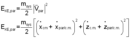

Our vector, velocity of a particle, is a bit long. But the vector magnitude, the speed, is gotten in the same manner as for simple vectors. To tidy-up a bit, we drop the notational reminder of time dependence, (t) .
Our equation now contains two "squares of sums." The principle terms of the squares are x c.m. and z c.m.. By the

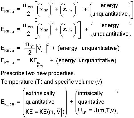

The above expression, though logical, cannot to made quantitative. The particle masses might be specified but it is impossible to state their speeds at any instance of time. Since none of the three terms can be evaluated; it appears we are at an impasse. A macroscopic perspective for fluid systems is needed.
Center of Mass: is a tight, compact perspective for regular solids in classical motion, thoroughly explained in physics and mechanics texts. Here the task of center of mass is messy. Its objective is to use center of mass to extract what might be measures of the three terms of Eqn. 2. The "center of mass concept" applied to solids is tidy. For regular solids, kinetic and potential energy transform cleanly. The energy of the solid sum is that of the density of regular solid geometries. Center of mass of a continua is a nebulous idea. Once energy associated with the center of mass is accounted for in a quasi-solid body manner, there is microscopic kinetic and potential energy un-included by the center of mass perspective. Activity of matter, showing energy, more energy than center of mass activities detail... By center of mass perspectives, the bulk motion energy describe

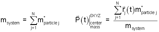

We don't intend to perform these operations but only to describe them. The center of mass is a moving position in space at which all of the mass can be assume to reside. Thus we sum to obtain that system mass. Next the first moment is used to establish the vector r (t), the location of the cm.
The above idea will locate the center of mass. It's position is named P (t). Next the position of any of the particles is written in two pieces as:

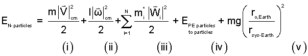

These changes permit the kinetic energy of N particles (which cannot be written) to be written in terms of the center of mass velocity plus a sum over W i, the relative velocities of particles.(IE_4a)
To this point we have expanded the energy of N particles (EN-particles) to be 5 terms.
- Term (i) is the translational kinetic energy of the sum of masses. If the center of mass does not move, this term equals zero.
- Term (ii) is the rotational kinetic energy of the mass of particles. The moment of inertia of the mass is I and its rotation rate is ω is the rotational speed.
