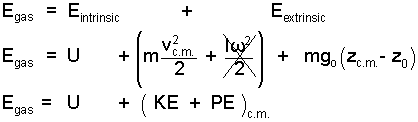

Kinetic energy has a rotational part which is relevant with many systems. We have placed a strike-through on those terms not because they are zero but because this writing will not consider that aspect of energy. In a similar but more abstract manner gas particle potential energies can be divided into extrinsic, "center of mass," and internal components. In conclusion the energy of a gas is written.
Air Energy 5
What has been argued for a gas applies as well for a liquid or solid. Internal energy and intrinsic energy, synonymous ideas, are easier to understand than the energy change mechanisms, intrinsic work.
