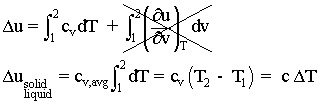

Immediately above, du is integrated (symbolically) to obtain a Δu. How to manipulate the second integrand so it can be integrated is an advanced topic. However, we notice that the integral will be zero for any substance event with constant specific volume. The is, if v = constant, then dv = 0. Solids and liquids are reasonably approximated as having constant density. Thus (with use of the mean value theorem) we have:
Partials 3
The specific heats of condensed phases (liquids and solids) vary with temperature. Careful, second-level analysis must account for this. However, in preliminary calculations, it is expedient to use the mean value theorem, and an approximated value for the specific heat. Values of specific heats are provided where needed.
