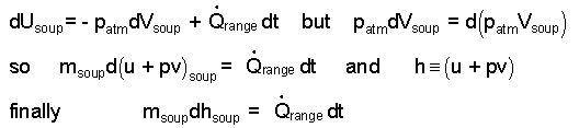

This is a first-order ordinary differential equation. The next step tpward solution is to separate variables.
E04
(4)
By definitions of calculus, the compression work term reduces to be the boundary pressure times differential volume. Also the boundary pressure of the soup equals the ambient pressure of the air.
E05
(5)
Some algebra along with the definition of enthalpy (h = u + pv) yield a final differential equation form.
E06
(6)
Next apply the linear integration operator to the equation. The limits of the integral "left-of-equality" are the initial and final state of enthalpy of the water. Right-of-equality the limits of integration are the corresponding times, commencement of heating and the "unknown," time of completion of the event.
E07
(7)

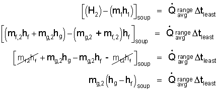

To proceed we must cast the initial and final enthalpies in terms their masses and specific enthalpies. The initial state is saturated liquid at one atmosphere. In the final state, some water remains as saturated liquid and some has "boiled-off" as saturated vapor. The subscripts " f " and " g " are used for the saturated liquid and vapor states, respectively. Some algebra is requires:
E08
(8)
Thirty percent of the original mass of saturated liquid is heated to become vapor. Thus the mass of vapor generated is:
mg,2 = 0.30 [4000 cm3(1 g/cm3] = 1200 grams.
(9)9
The enthalpy of phase change (some call this "latent heat of caporization at one atmosphere") is:
hg - hf = (2675 - 419) J/g
(10)10
Entering these numbers we obtain the "least" time required.
D116 Eqn5
(11)11
