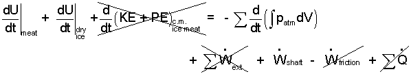

♦  Take the system to be the meats (with properties approximated as those of water) and the dry ice. This is an "increment" type event. However, we begin by writing the rate form of the energy equation. The rate form is always used since it reduces to the other forms as will be shown:
Sausage Eqn 1
(1) 1
We inspect the energy equation, term by term beginning with the Σ at the left. That summation applies because two substances pass through the grinder. The internal energies of the dry ice, Udry ice, and meats, Umeat, will change. However, we expect inconsequential (center of mass) changes of kinetic or potential energy for the dry ice and meats (water) (X). Zero extrinsic energy change also means zero extrinsic work (X). We write the rate of "compression work" as two pieces - one for dry ice, the other for the meats. There is a single shaft work, that of the grinder motor. This leaves frictional work and the sum of heats. Both frictional work and heat will increase the amount of dry ice needed - we assume frictional work and heats are negligibly small (/).
Finally, the heat term is always difficult to evaluate. Here we seek the least dry ice required which will correspond to the sum of heats ΣQ being zero. The next stage of our equation is:
Sausage Eqn 1a
(2) 2
Processes of the water and the dry ice begin at a pressure of one atmosphere and terminates at one atmosphere. For that reason, pressure is assumed constant for the water and carbon dioxide. Recognizing this we change the integrals as follows:
Sausage Eqn 3
(3) 3

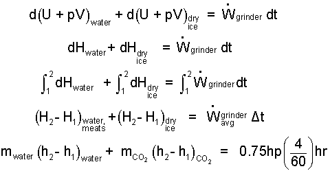

Multiply the equation by "dt." On the right side, multiplication by "dt" leaves the combination "d∫." Do you remember that from calculus? The result is:
Sausage Eqn 4
(4) 4
The very convenient grouping enthalpy (U + pV) occurs often in thermodynamnic analysis. We group the terms.
Sausage Eqn 5
(5) 5

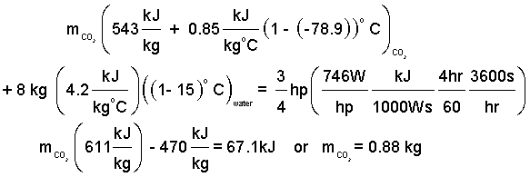

We must now express the enthalpy differences quantitatively. Since we know more about water than carbon dioxide, we apply the solid principle "easier things first." The meat, approximated to be water, enters the grinder modeled as a liquid and leaves colder but still liquid at 1°C. The second, or exiting enthalpy is greater than the first.
Sausage Eqn 7a
(6) 6
We know the specific heat of water and its entering and leaving temperatures. The difference we seek is:
Sausage Eqn 7b
(7) 7
The CO2 is initially solid at one atmosphere and has a low energy. During grinding its energy increases with its phase change from solid to gas (heat of sublimation) and thereafter by its temperature increase to that of the meat, 1°C. The energy of each of these changes is positive. Thus we write the second enthalpy of the dry ice as:
Sausage Eqn 6a
(8) 8
The difference we need is:
Sausage Eqn 6b
(9) 9
The brief table provides properties of Carbon Dioxide.
Sausage Preparation
Carbon Dioxide at 101 kPa
T (°C) ρsol(kg/m3) ρgas(kg/m3) hsol(kJ/kg) hgas(kJ/kg) cp,vap(J/g°C)
-78.9 1565 2.51 70 643 0.85
Carbon Dioxide, (CO2), sublimes at -78.9°C
Sausage Eqn 6c
(10) 10
The property information for water and carbon dioxide are entered into our equation.
Sausage Eqn 9
(11) 11
