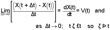

Next we divide by Δt and let Δt → 0. Left of equality we get dG(x,t)/dt immediately. We will explain the steps for "right of equality."
The density and area move ahead of the limit operation; they contain no Δt.
Look as the expression aboe right. Notice that as Δt vanishes, in the limit we have: t ≤ ζ ≤ t. Thus ζ is squeezed to become t.
We obtain:
