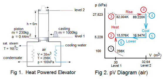

It is pro­posed to construct an elevator to operate in conseq­uence of successive heating and cooling of air, the working substance. The apparatus will consist of a piston and cylinder. Figure 1 shows the intended elevator dimensions and specifications.
By inspection of the schematic we understand elevator operation will be five steps. A p-V diagram for the air is needed. States of the air are determined as the p-V diagram is sketched: Figure 2.
Apparat And P V Air

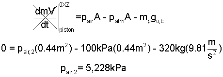

♦  Preheat: States (1) to (2):  The elevator is charged with air initially in equilibrium with ambient surround­ings (298K, 100kPa, 30m³). The piston mass and area are 230kg and 0.44m³. Therefore (by Newton's 2nd Law) the air must have the pressure p4 = 5,228 kPa before the piston will start to rise.
eqn_1_2
To calculate the heat (1) to (2) we require temperature, T2:
T4air

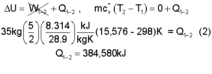

Preheat happens at constant volume hence work is zero. The energy equation is:
Q_1_2
This brings us to State (2) (35kg, 30m³, 5,228kPa, 15,576K), the first state of intended cyclic operation of the elevator.

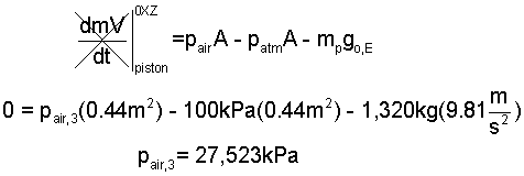

♦  Heat to Commence Lift: States (2) to (3)  The air must attain pressure sufficient to lift the piston and casting. For pressure use the 2nd Law.
eqn_1_2
At state (3), assume air is an ideal gas so:
eqn_1_2

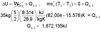

Heat the "Heat to Commence" is:
Q23

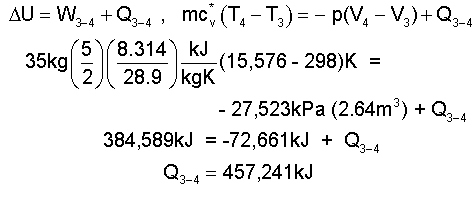

♦  Heat of Lift: States (3) to (4)  The volume of air will increase to 32.64m³ as the air pressure remains constant. Thus we know the conditions of State (4) (30kg, 32.64³, 27,523kPa and T = T4. We might calculate W3-4 independently. However let's apply the energy equation and obtain work and heat together.
W34 Q34
