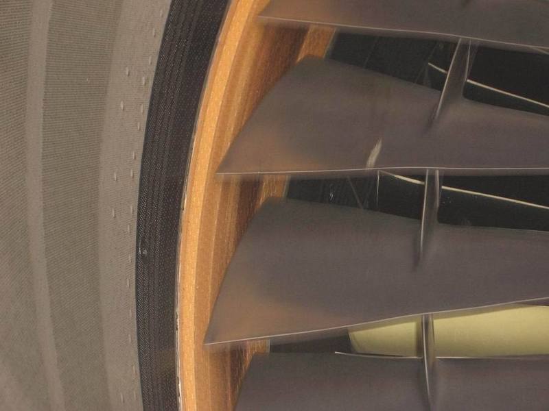

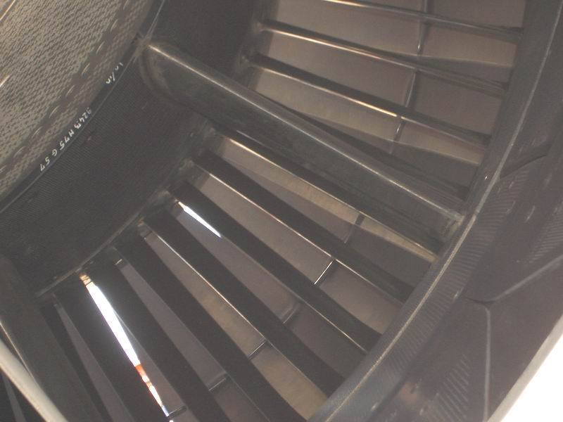

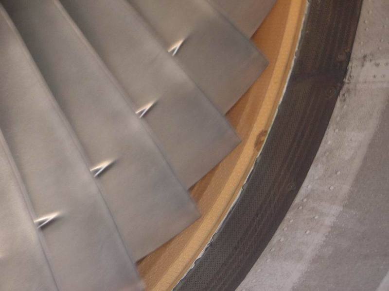

These details look very odd to me, taken at a local airshow last week at Willow Run (FedEx jet). Do these steps and bevels or cants help reduce noise?
http://s184.photobucket.com/albums/x295/kach22i/

It's difficult to say exactly what each fan designer had in mind with each specific piece of geometry. As I mentioned before. the tip area, especially on a large diameter fan, is going to have a lot of supersonic shock issues. That means noise. So pretty much any design is an effort to increase the efficiency and decrease the noise at the tips.
If you mean the snubbers (the cantilevers sticking out of each blade at about 2/3 of the blade height) their function is to control vibration, not noise reduction.
When the engine is running, the blades twist and the snubbers press against each other to act like a solid ring. That has a big effect on the lowest vibration frequency of the blades, and eliminates some aerodynamic stability problems (a.k.a. flutter). The disadvantage is they partly block the airflow through the fan.
Modern fan designs have longer blade chords and "hollow" blades (actually, lightweight composite structures inside the blade) to control these vibration issues without using snubbers between the blades.

AlephZero are you calling the vane riblets "snubbers"?
Will the turbofan's blades will be pulled foreward and well into the larger part of the duct opening under full speed? You see the level changes there (right?), one is sloping a little.
This cannot be good for tip blade vortex generation, right?

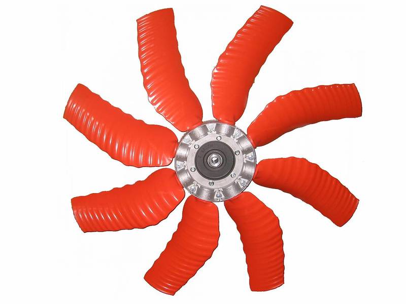

Fan (computer fans) sweeped (maybe not sweeped, don't know how say, may "FAN BLADES with concave leading edges") to get more thrust at smallest size, i think.
How would this work?

god that boeing fan blade is a work of art...
I wonder what one of those bad boys would cost...
