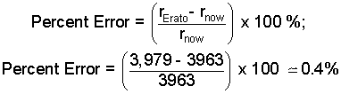

Today the measured radius of Earth is taken to be 3963 miles. Thus, supposing 3963 miles is the actual radius, the percent error of Eratosthenes' measurement was:
Equation (5): Percent Error = ((r_Erato − r_now) / r_now) × 100%; Percent Error = ((3,979 − 3963) / 3963) × 100 ≈ 0.4%
(5)
The "sign" of this error is positive which means the
value determined by Eratosthenes was greater than
the present day, accepted value.
Thus his measurement of the Earth circumference (some 2000 years ago) was in error: Less than actual by only one-tenth of a percent. Very close, indeed!
