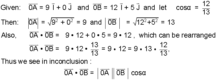

Scalar Multiplication of Vectors. Vectors can be multiplied in a scalar manner or a vector manner. We will want to know about scalar multiplication. That operation proceeds as follows:
Equation (8): Given: 0A = 9 I + 0 J and 0B = 12 I + 5 J, and let cos α = 12/13. Then |0A| = √(9² + 0²) = 9 and |0B| = √(12² + 5²) = 13. Also 0A • 0B = 9•12 + 0•5 = 9•12, which can be rearranged: 0A • 0B = 9•12•(13/13) = 9•13•(12/13). Thus we see in conclusion: 0A • 0B = |0A| |0B| cos α
(8)8
This simple operation shows that scalar multiplication of two vectors produces a scalar which equals the magnitude of one vector times the magnitude of the other, times the cosine of the smaller angle between them. Were it the case that the vectors were perpendicular, the cosine of 90° would equal zero, hence the scalar product is zero.
