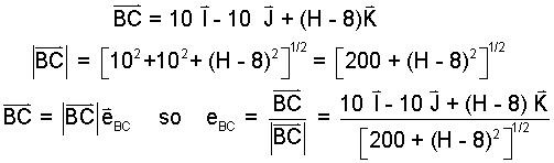

Next we go after eBC which is the direction of vector BC. We use the vector equation,
0B + BC = 0C.
Writing this directly,
(0 I + 10 J + 8 K) + BC = (10 I + 0 J + H K)
which solves for BC and then to yield eBC as:
Returning to the beginning equation, we have:
|0P|e0A = ( 0 I + 10 J + 8 K) + |BP|eBC
So we put the pieces into it.
Vectors are ordered numbers associated with previously prescribed directions. The term, "ordered triple" is used sometimes. The vector procedure is always the same. The next task is to separate the above messy equation (carefully) into components. One way is to successively collect all I, then J and then K pieces left of equality such that their vector sum equals zero. Then, if a vector equals zero, the magnitude of each of its components must equal zero - this produces three scalar equations to solve. A second technique (used here) is to scalar multiply the vector equation successively by I, then J, then K. The result is the same three scalar equations. See below:
The three unknown quantities are |0P|, |BP| and H. Manipulating these equations one obtains:
