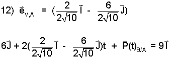

Next we substitute the unit vector direction of movement of "A" into its equation. Note we omit units in this equation.
4 Eqn 12
(12)
