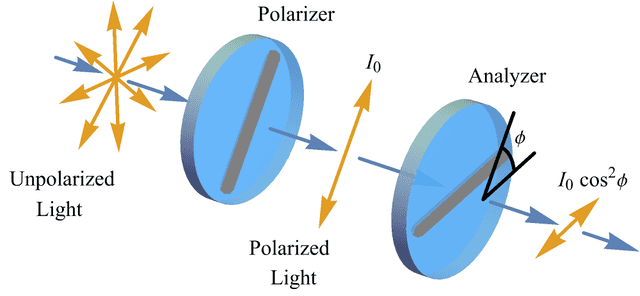

When vertically polarized light with intensity ##I_o## passes through a polarizer making an angle ##\phi## with the vertical, electromagnetism says the intensity of the light that passes through the polarizer is ##I_o\cos^2{\phi}## and that light will now be polarized along the polarizer (Analyzer) orientation (Figure 1). To create our qubit, start with a source of vertically polarized light and reduce its output to one photon at a time. If the frequency of the light is f, then the energy of each photon is hf where h is Planck’s constant. This is our photon-polarization qubit.
Figure 1
Now send each photon to a polarizer making an angle ##\phi## with the vertical, what does classical electromagnetism say we should find on the other side? Well, since electromagnetism says ##I_o \rightarrow I_o\cos^2{\phi}## (Figure 1), we expect ##hf \rightarrow hf\cos^2{\phi}##. But since a polarizer does not affect the frequency f of the light, that would mean Planck’s constant h has effectively been reduced to ##h\cos^2{\phi}## due to a spatial rotation of the polarizer from the vertical. This violates the observer-independence of h (per Information Invariance & Continuity) as justified by the relativity principle (“no preferred reference frame” NPRF), so quantum mechanics says we instead find each photon either passes in its entirety with probability ##P(1|\phi) = \cos^2{\phi}## or it does not pass at all with probability ##P(0|\phi) = \sin^2{\phi}## so that the average energy that passes equals ##hf\cos^2{\phi}##. That is, NPRF + h leads to the ‘average-only’ transmission of photons through polarizers just like it leads to the ‘average-only’ projection of spin angular momentum for electrons. This produces a violation of the Bell-CHSH inequality as follows.

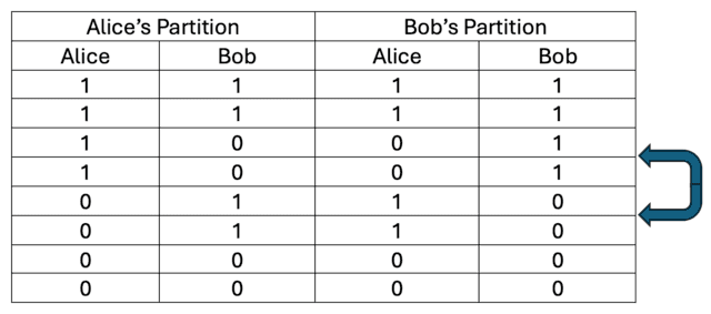

Well, just as with the spin-##\frac{1}{2}## Bell triplet state (see this Insight), Alice argues that Bob’s ‘underlying’ photon polarization must be the same as hers because when Bob’s polarizer orientation is the same as hers, his photon is always V (passes) when her photon is V and his photon is always H (fails to pass) when her photon is H (again, as necessary to conserve angular momentum). So, according to Alice, when Bob’s polarizer makes an angle ##\phi## with respect to hers, his photon has a probability of ##\cos^2{\phi}## of passing through his polarizer in those trials when her photon passes through her polarizer (50% of all trials) and a probability of ##\sin^2{\phi}## of not passing through his polarizer in those trials when her photon passes through her polarizer (per ‘average-only’ transmission). That means ##P_{VV}(\phi) = \frac{1}{2}\cos^2{\phi}## and ##P_{VH}(\phi) = \frac{1}{2}\sin^2{\phi}##. Of course, Bob can make the same claim about Alice’s photon so he agrees that ##P_{VV}(\phi) = \frac{1}{2}\cos^2{\phi}## and adds ##P_{HV}(\phi) = \frac{1}{2}\sin^2{\phi}##. Normalization then says ##P_{HH}(\phi) = \frac{1}{2}\cos^2{\phi}##. In other words, the joint probabilities per NPRF + h are:

Consequently, we have Figure 3 for our photon Bell triplet state analogous to Figure 7 for our spin Bell triplet state. Figure 3 shows an example collection of eight data pairs when Alice and Bob’s measurement settings in the symmetry (V-H) plane for a photon Bell triplet state differ by ##45^{\circ}##. Alice partitions the data according to her pass (1) results to show that Bob’s measurement outcomes only average the required ##\frac{1}{2}## for conservation of angular momentum in those trials. But, when Bob partitions the data according to his pass (1) results (by switching the middle four rows of Alice’s partition as shown with blue arrows) he can show it is Alice’s measurement outcomes that only average the required ##\frac{1}{2}## for conservation of angular momentum in those trials.

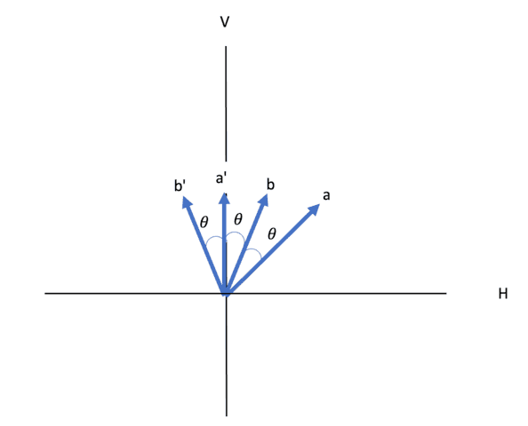

##S := E(a,b) – E(a,b’) + E(a’,b) + E(a’,b’)##
where ##a,a’,b,b’## are four polarizer angles with respect to the vertical in the V-H plane (Figure 4). If you assume that each photon has some definite polarization in each trial of the experiment, Dehlinger & Mitchell show that ##|S| \leq 2##. However, using the joint quantum probabilities above we have ##E(\alpha,\beta)=\cos{(2(\alpha-\beta))}## so
##S := \cos{(2(a-b))} – \cos{(2(a-b’))} + \cos{(2(a’-b))} + \cos{(2(a’-b’))}##
Using the angles shown in Figure 4 where ##\theta = 22.5^\circ##, we see that quantum mechanics predicts ##S = 2\sqrt{2}## thereby violating the Bell-CHSH inequality. In 1980, Boris Tsirelson (also spelled Cirel’son) showed that this is the largest possible violation of the Bell-CHSH inequality for quantum mechanics. So, we see that entangled photon-polarization qubits violate the Bell-CHSH inequality to the Tsirelson bound per Information Invariance & Continuity (observer-independence of h) as required by the relativity principle (NPRF).
