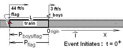

Event State upon Initiation
The sketch depicts the boys (moving with speed, 3 ft/s) with the train immediately abreast and moving past them. Its speed is 44 ft/s. This instant shown is the starting time of our event.
Event initiates, t = 0+: a train of length L moving at 44 ft/s with a flag at its rear; boys walking at 3 ft/s stand at the train's front at the origin; positions P_flag and P_boys/flag marked along the X axis.
We associated the time (at that instant) as "commencement" of the "train-length measuring event." We notate that time as "time equal to zero-positive, "t = 0+." The meaning of "zero-positive" is the idea "a clock has been started and is running." At that instant (clock running) we imagine establishment of a one-dimensional coordinate reference (an X-axis) with its increasing direction toward the destiny of the train. We place the origin or zero value of that axis at that instant on the ground beneath the boys. As vector basis we select the unit vector, I, directed to coincide with positive X.

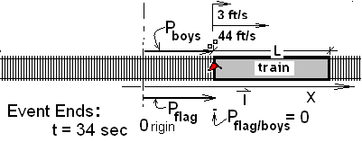

The boys mark "end of the event" as that instant We discuss the termination of this event next. The sketch shows characteristics of the event at its moment of termination, a time we call: t = 0+ + 34 seconds."
Event ends, t = 34 sec: the train's rear flag has reached the boys; P_flag/boys = 0, with positions P_boys and P_flag marked from the origin.

These terms are vectors in the direction,I. At time,t = 0+, the boys are at the origin (0 I) and the position of the flag is L(- I). Their speeds are 3ft/s I and 44ft/s I respectively. Thus our vector equation becomes:
0 I + (3 ft/s I) t + PF/B(t) = L (-I) + (44 ft/s I) t

Physically, the event ends when the flag is opposite of the walking and counting boy. At that time the vector position of the flag relative to the boy, (PF/B) has zero length Notice its direction is not zero; its magnitude is zero). We rearrange to have PF/B, left of equality.
PF/B(t) = - L I + (44 ft/s) I t
(7)7
This equation fits the initial condition. At time, t = 0+, the flag is L feet behind the boys.
Now at t = 34 seconds, the boy and flag are beside each other. Hence:
PF/B(t = 34s) = 0
(8)8
0 = - L + (44 ft/s)( 34 sec) and, L = 1394 feet.
