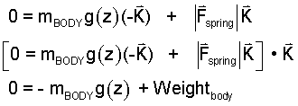

Next Newton's Second Law is applied. The momentum is constant, its derivative is zero (left-of-equality). The BODY force is gravity. The surface forces are the pull of the spring and the "float" of the ambient air. We assume the ambient density to equal zero. Hence pressure forces over tht BODY are zero.
Momentum Eqn 1
(1) 1
The magnitude of gravity is mg and it acts in the "-K." The magnitude of the spring force is not known but it acts in the "K." Put these ideas in and solve.
Momentum Eqn 2
(2) 2
This calculation was made swiftly by ignoring the density of the ambient gas. More on this later.
