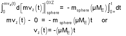

Integration of a first order differential equation follows the steps: separate variables, apply integration and place appropriate limits:
Free Fall New 2
(5) Separate variables and integrate.

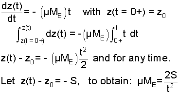

Represent v(t) as dz(t)/dt then separate variables and integrate again.
Free Fall New 3
(6) Integrate once again..."
Thus, had Newton been able to accurately measure the distance and time of free fall of a body, he could have determined the value of μ MEarth. But that was difficult because a fall of 10 meters (~30 feet) requires only 1.4 seconds (as we now know). Clocks in the 1650's were inaccurate at timing such events. Ways other than direct free fall had to be found. Two such alternative ways discussed here are Galileo's Inclined Plane (shortly below) and Atwood's Machine.

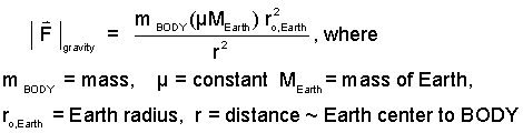

The magnitude of μME has been determined to be (of sufficient accuracy for our purposes): 9.81 m/s² (or 32.2 ft/s²). The group μMEhas been given a new symbol, go,E which is called the "Earth surface acceleration of gravity." When this result is substituted into Newton's postulated equation the magnitude of the force of gravity is made quantitative as:
G Naught1
(7) 7
Equation (7) shows the dependence of the force of gravity on "r", the distance from Earth's center to the BODY. For many engineering calculations the approximation, r ~ ro is reasonable such that, |Fgravity| ~ msysgo.
