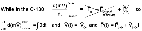

Solution:  We will solve this problem somewhat "at length" by looking at phases of the jump.
i) Before the jump:  For this phase we set our time period to be indefinite, to start at t = 0+ and to continue to unspecified times later, t. While standing in the C-130, the acceleration of the soldier is zero and his velocity is 350 m/s. The momentum equation for this event is:
A431 Eqn0
(1)(1)
