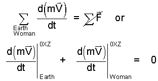

♦  Exaggerated sketches of the "before" and "after" are shown. We will use the momentum equation (Newton's 2nd Law) with the system being both Earth and the woman. The momentum equation written with the discrete summation sign is:
eqn1
(1)
The sum of forces equals zero because
there are NO forces. All interactions
we might think of as forces are inter-
ior to the system.

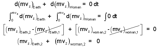

The velocities for this event have only K components. So when we vector multiply by "•K" (scalar multiplication) the velocities become z-component velocities or "vz's." We make that multiplication, separate variables of the differentials, then integrate between limits.
eqn2
(2) 2

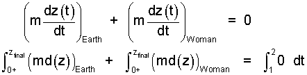

Next we express velocities, "vz," as "dz(t)/dt." Make that substitution, separate variables again, then integrate once more.
eqn3
(3)3
Perform the integrations:
eqn4
(4) 4

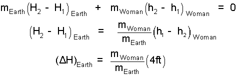

The two masses, taken as a system, experience no surface forces during the event. Therefore the center of mass of the system does not move. It is sufficient for us to assume the elevation, Zc.m. and then set it as a zero datum for the event. Thus the elevations of the above equation are "relative" to the location (zero value of z). We enter the elevations with some algebra:
eqn5
(5)5
The Bishop is correct that mutual gravity caused Earth to move up. However we see that the amount of movement is very small. The tremor many people felt must have been a minor Earthquake.
