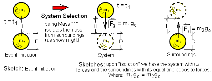

Analysis requires that a system be chosen. We choose the system to be Mass "1,", m1. The next step, according to Newton, is to "isolate" the system schematically and ascribe too it whatever forces might apply. In choosing a system (below center), all else of the physical situation (below left) becomes surroundings (below right).

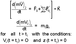

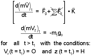

At this point, having Mass "1" as the system, we can specify spatial coordinates then apply Newton's Law of Motion to that mass - "1."
Free Fall of Mass "1": The above sketch of system with coordinates, governing differential equation and initial conditions constitutes what is called a consistent set or statement for solution of the event. That solution states that the mass, beginning with zero velocity a distance H from Mass "2," moves with increasing speed toward Mass "2." While this solution might be effected now, let us first consider the other mass, Mass "2."

The statements of, "Free Fall of Mass 1" and of "Free Fall of Mass 2" simply initiate the solution. Before we proceed recognize that with Mass "1" as system, Mass "2" is its surroundings and for Mass "2" as system, Mass "1" is its surroundings. For either system there is a force "on the system" and on its respective surroundings, an "equal and opposite force" applies. When a system and its surroundings are combined the system perspective ceases to exist and the "equal and opposite" force-pair sum to zero. That is, combine the system and surroundings (either mass as system) yields the sketch, "Event Initiation." Expanding on this idea:
It is true that for every force there is an equal and opposite force. This means that all forces are pairs and that each pair sums to zero; hence there are no forces. But much is made of forces in physics and mechanics. How can this be?
The answer is subtle. Newton isolated the system from surroundings. While the system and surroundings were together, many "force-pairs" acted. But upon "isolating" of the system from the surroundings one force of the pair acted on the system, the other on the surroundings."
