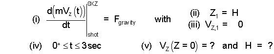

Although high school physics has provided equations to determine these answers, rarely do those courses show the source of the equations and how they are obtained. Below we show the source of those solutions using Newton's Momentum Equation applied to a body:
(6) Differential equation and initial conditions for the fall of a shot.
Expression (i) is the momentum equation with only the force of gravity acting. Momentum of the shot has only vertical components; VZ(t) is the vertical velocity as a function of time. Expressions (ii) and (iii) are called "initial conditions" which state that the initial (t = 0+) height is H and the initial vertical velocity equals zero, respectively. Conditions are required to solve the differential equation. Note (iv) denotes the time domain of the event which occurs in the time span 0+ ≤ t ≤ 3 seconds. Finally (v) identifies the quantities to be determined, the speed when the shot is at ground level and the height of the fall. We will bypass the complete solution of the differential equation for now.

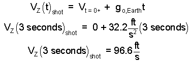

To obtain numbers We use a familiar equation from physics which provides the velocity as:
b
(7)

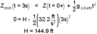

A second equation from physics can be applied to determine the required height of the tower.
(8)
