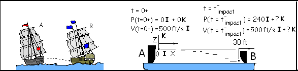

Suppose Ship A fires a cannon, aimed horizontal, at Ship B. The shot mass is 24 pounds. Assume its muzzle speed constant at 500 ft/s over its flight. What does Newton's Second Law tell us about "Point Blank?"
The origin is the muzzle of the firing cannon. The extrinsic properties of the shot an instant before it impacts the ship (t = t impact-minus) are its position, velocity, and kinetic energy. The momentum equation with its initial and final conditions is given.
Two sailing warships A and B firing at close range, with a schematic: at t = 0+, P = 0 I + 0 K and V = 500 ft/s I at ship A; at t = t_impact, P = 240 I + ? K and V = 500 ft/s I + ? K at ship B, 30 ft away.
Solve the momentum equation to determine the velocity, speed and momentum of the shot an instant before its impact with Ship B.

We set our coordinate origin to be at the cannon muzzle in Ship A (See figure). Both ships move at near equal speeds on parallel courses. The differential equation and initial conditions for this event are:
Equation (1): d(mV)/dt (shot, 0XZ) = ΣF
(1) 1
The above equation integrates twice to yield:
Equation (2): P(t) (shot, 0XZ) = P_0+ + V_0+ t − ½ g_o t² K
(2) 2
With conditions applied, the equation becomes:
Equation (3): 30 ft I + z K = (0 I + 0 K) + 500 (ft/s) t_impact I − ½ (32.2 ft/s²) t² K
(3) 3
Separate the equation into I and K components then solve.
Equation (4): I: 30 ft = 500 (ft/s) t_impact, or t_impact = 0.06 s. K: z = −½ (32.2 ft/s²) t², or z = −0.6 ft
(4) 4
Thus after 0.48 seconds, the shot would be about to impact Ship B, 3.7 feet below the bore line of its cannons (assuming near identical ships).

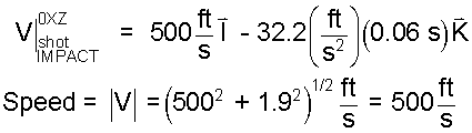

A single integration of the momentum equation gives:
Equation (5): V(t) (shot, 0XZ) = V_0+ − g_o t K, or V(t) = 500 (ft/s) I − 32.2 (ft/s²) t K
(5) 5
Inserting the time "instant prior to impact," 0.48 s, the velocity just prior to impact is:
Equation (6): V (shot, 0XZ, at impact) = 500 (ft/s) I − 32.2 (ft/s²)(0.06 s) K; Speed = |V| = (500² + 1.9²)^(1/2) ft/s = 500 ft/s
(6) 6

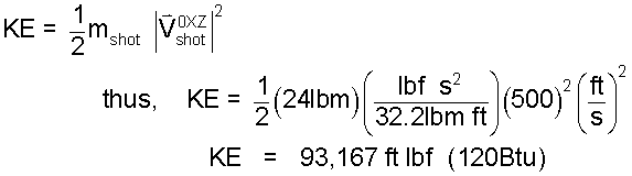

♦ Kinetic Energy: In coming to rest after impact with the ship, nearly the entire kinetic energy of the shot will be transferred to the target ship. That amount of energy is:
Equation (7): KE = ½ m_shot |V_shot|²; thus KE = ½ (24 lbm)(lbf s² / 32.2 lbm ft)(500)² (ft/s)²; KE = 93,167 ft lbf (120 Btu)
(7) 7
