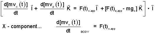

The X-component obtains by vector scalar multiplication by the unit vector, I:

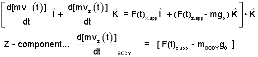

The Z-component is obtained by scalar vector multiplication by the unit vector, K.
These operations are easy to understand. Notice the manipulation of form can be reversed. Simply multiply the result above by K, the result above that by I, then add them to obtain the equation at the top of the page. To be prepared for what follows, commit these steps to memory. While the vector form is preferred for investigations of motion, an exception arises soon when kinetic energy, potential energy and work of a body are explained.
