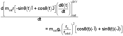

Next write Newton's Second Law:
Now enter momentum (Eqn-3) into Eqn-4. Also write the gravity force.
A longer equation needs more paper.
In the differentiation above, left of equality, keep in mind that dθ(t)/dt is a constant. This angular speed of the satellite is 2πrad/24hr. Differentiate then gather terms.

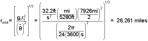

Is this right? Check everything above.
Our answer, 26,261 miles is referenced to the Earth Center. Accounting for the diameter of Earth, changes the above answer to 22,298 miles (above Earth surface).
