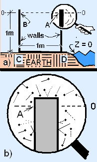

Sketch a) depicts air at a typical location on Earth at sea level (z = 0). Two walls extend upward from Earth into the air a height of one meter. Atmospheric air bounds the walls on their sides and above and fills the space between them.
Two sketches: a) a container with walls 1 m apart and 1 m high standing on Earth beside water at Z = 0, with a magnifying glass over a wall at point A; b) the magnified view of fluid particles striking the wall at A.
Consider a cubic meter of air defined imaginary, Sketch a), as the one meter by one meter square in the plane of the page (A-B-C-D) and one meter of depth into the page. Modern physics has established that on average in time that space between the walls contains some 25 x 1021 particles.
That is an enormous number of particles but the particles (mostly diatomic nitrogen and oxygen), are so very small that more than 99.99% of the space of the cubic meter is void of matter. We see through air because its particles occupy scarcely 0.01 percent of the space it exists within.
Sketch b) depicts part of the physical situation seen through a very powerful magnifying glass. One wall is seen from its end; the particles of air in its vicinity immensely exaggerated in size. and vastly reduced in number. The few particles are depicted as moving in all directions at speeds as fast as 1000 miles per hour. Obviously some of these particles will collide with, we say, "impact" the wall; and others will cross the plane 0 - 0 moving into the space as others at the same rate cross plane 0 - 0 leaving the space.
