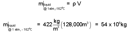

♦ Mass (m), density (ρ) and volume (V) are related as: m = ρ V. The volume of the hold and the density of the liquid LNG, are provided, hence:
Equation (1): m_liquid at 1 atm, −162°C = ρV; m_liquid at 1 atm, −162°C = 422 (kg/m³)(128,000 m³) = 54 × 10⁶ kg
(1)
Mass equals density times volume.

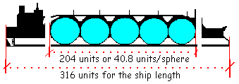

Estimate the length of the tanker.
♦ A first step is to calculate the diameter of the identical spherical tanks using the volumetric capacity and the formula for the volume of a sphere.
Equation (3): 5 V_sphere = 128,000 m³, therefore V_sphere = 25,600 m³, or π D³_sphere / 6 = 25,600 m³. Hence D_sphere = 36.6 m
(3)
Approximate diameter of a spherical tank.
A ruler might be used to measure the length but we used a graphics software to scan the tanker profile. The scan was then adjusted by moving the spheres to eliminate the space between them. Finally the software was set to display a grid over the image.
Silhouette of the LNG tanker with scale marks: 204 units or 40.8 units per sphere, and 316 units for the ship length.
A count of grid units of the width of the 5 spheres yielded 204 units, meaning the diameter of each sphere is 40.8 units. But we have already determined that the spheres are 36.6 meters in diameter. Hence the scale is that each grid unit represents 0.9 meters. The count of the grid units in the full length of the tanker image is 316 units. Thus 313 units x ( 0.9m / unit) = 283 meters.
Estimate the beam of the ship.
♦ The beam of the ship is its widest width. The tanker must be at least as wide as the diameter of one sphere. That would be 36.6 meters. But the beam measurement would also include two "thicknesses" of the hull. Estimate the hull thickness to be 2 meters then the beam of the tanker would be approximately 40.6 meters.
