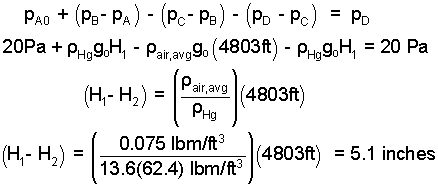

We can combine i), ii), and iii) to determine: H1 - H2
There is an easier way to solve hydrostatics problems. We recognize the two known pressures (at the top of the barometers). So we write one equation combining the pressure differences.
Puy 7
(7)7
Observe:  Pressure at A increased by the column of mercury (going down, therefore "+") decreased by the column of air (going up "-") decreased by column of mercury (going up "-") equals pressure at D.
