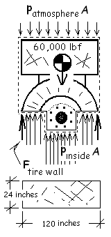

Solution:  For this approximate calculation we envisage a special, silly-looking physical scenario consisting of a single tire configured to support one-sixth of the load or 60,000 lbm [(360ton x 1,000lbm/ton)/6]lbm. The scenario resembles a giant unicycle.
Next, to apply Newton's 2nd Law, we must "extract a system" from our scenario. It is "with the system" that forces and pressure-forces apply. For air pressure in the tire to support the truck, that air pressure (acting over an area to be a force) must be a boundary force of the system. To make that boundary force relevant to the system, we pass the system boundary through the tire and the air it contains. Of course the tire walls will help support the load. Since we cannot calculate that support we must assume it is negligibly small.
Our system sketch is shown to the right. Notice how we "cut it around" the tire hub. While drawing the system boundary be sure to include atmospheric pressure which acts over its top.

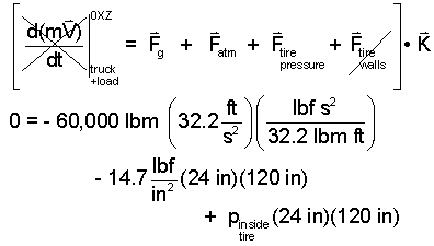

Calculations with attention to units yield:
sol
Were a tire gage applied to our approximated tire, the gage would read 20.8 psi, meaning the pressure within the tire is:
14.7 psi + 20.8 psi = 35.5 psi.
