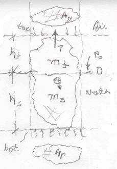

Floating Buoyancy:
Pencil sketch of a body partly floating in water and hanging from a cord: tension T, floating part m_f above the water line in air, submerged part m_s below, heights h_f and h_s, and top and bottom areas A.
A solid in equi­librium on Earth rests upon solid Earth or is supported in some floating freely partially or fully submerged in a fluid, perhaps assisted in equilibrium by an external tether or such which, in turn, rests or anchors to solid Earth. There are a number of possible arrangements.
Stable solid/fluid configurations depend upon the mass of the solid and fluid densities. Here we consider the case of a solid floating beneath air and above water.
Shown right is sketch of a mass of arbitrary shape. The mass "floats" as we say. The part that floats (notated "f") is above the water level surrounded by air. The part of the mass surrounded by water is notated "s" for submerged. A vertical projection of the mass (its area seen from the "vertical") is needed: "A." What does Newton's 2nd Law tell us?

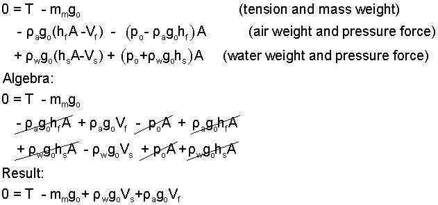

d(mV)/dt (system, struck out as zero) = ΣF_ext + ΣF_gravity − ΣF_surface
0 = T − m_m g_o (tension and mass weight) − ρ_a g_o (h_f A − V_f) − (p_o − ρ_a g_o h_f) A (air weight and pressure force) + ρ_w g_o (h_s A − V_s) + (p_o + ρ_w g_o h_s) A (water weight and pressure force). Algebra: cancelling terms. Result: 0 = T − m_m g_o + ρ_w g_o V_s + ρ_a g_o V_f
The final equation above indicates that the required tension, T is diminished by the presence of both the air and the water and this is in proportion to the "displaced " air or water, respectively. Next we do a tad more algebra to obtain as below:
0 = T − m_m g_o + ρ_w g_o (V_s + (ρ_a/ρ_w) V_f), with the air term struck out; 0 ≃ T − m_m g_o + ρ_w g_o V_s
The third, right-most term of the equation above is called the "buoyant force." Notice this is the mass of water displaced. The volume of which is the volume "submerged."
