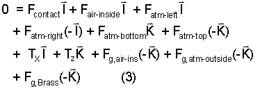

Scenario-2, shows our hemispherical half-shell (1/2 the sphere) placed inside of an imaginary half-cube. We label the faces of "half-cube" in coordinate pairs as "left and right (x-coord), "front and back (y-coord)" and "bottom and top (z-coord)." Ideally we would draw representations of pressure forces, gravity and tension on Scenario-2 thereby making it a free body diagram. Although graphical difficulty prevents further drawing, we can write the right side of Newton's 2nd Law. Upon the sphere act the forces of pull, represented as T, for tensions, each team of horses. All gravity forces act downward, (-K) and where there are gas at the boundary act pressure forces (pressure times area).
    B654 E02
As a first simplification can we agree that the pressure distributions of atmospheric air over the front face and the back face are identical, whereupon the forces,
(patm-front x A) J + (patm-back x A(-J) = 0
sum to zero. With this fact our half-cube becomes two-dimensional. The list of forces for Newton's 2nd Law are written (Eqn-3). The 2-D system FBD is below right:
B654 E03

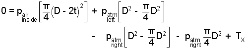

A simpler, X-component perspective is possible. FBD-1 becomes FBD-2 when we select its 0XZ perspective. Also to multiply Eqn-3 by the unit vector I yields - Equation-4. To procede an understanding of areas of "left-face" is needed. See below left.
B654 E04
Acting over the square left-face of the system are: (1) the solid-solid contact force of the removed hemispherical brass shells, (2) gas-to-gas contact of the interior gas and (3) exterior, atmospheric gas. These pressure-associated conditions of equilibrium act over a surface and are distributed. The effect at the brass-interface is similar to "pressure."
In display these are shown as many "arrows" directed perpendicular to the surface. The "arrows" represent localized forces being the product of the pressure over an elemental area of the related system surface times that area. The locations of gravity forces are at each "center of mass."

Applying some algebra:
B654 E09
(9)
Next we investigate a logical limit of Equation (9). For the realistic case that the shell thickness is much less than the shell diameter, the terms 4(t/D) and 4(t/D)2 are small and the rope x-component force becomes:
B654 E10
(10)

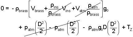

Tension ~ Z-component: 3 To inspect the vertical component, we extract FBD-3 from FBD-1 (shown right). The terms are a bit awkward to write.
B654 E11
(11)
Explicitly, the forces are mass times gravity or pressure times area.
(12)
For all of the forces we have:
(13)
The density of the brass is greatly larger than that of air inside or atmospheric air. Therefore we rearrange the first three terms as below. Also expand the next to last term.
(14)
From Eqn-10 we have the X-component of force of the horses. Eqn-13 is the Z-component. Adding (10) and (13) we obtain the vector force, T = TXI + TZTXI.
(15)
Now that the problem is over, did you see us apply the "Buoyancy Force?" That's the term rightmost in equation (15). When forces are summed properly, the "mass of fluid displaced" just "comes out in the wash."
