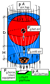

The information of the sketch (below right) depicts the balloon, horse and everything in air, just above the lift-off platform, an instant after it left the ground. The mass of the horse/equipment and the diameter of the balloon were 500 kilograms and 20 meters, respectively. Centers of mass of system components are shown.
Calculate the least temperature of the air within the balloon for the ascent to commence.
Free-body diagram of the hot-air balloon inside a column of cold air of height H + D: pressure p A on the air at top and bottom, gravity on the hot air F_g,hot air, on the cold air F_g,cold air and on the horse, rider and equipment, above a liftoff platform. ♦ Having experience in analysis, we select our system as a cylinder of air that encompasses everything. A sketch, free-body-diagram is shown (right). At ground level the pressure of air is atmospheric pressure. The balloon is open at its bottom. Newton's 2nd Law applies, the vertical component of the momentum equation is:

The balloon, before it commences to rise, is supported by the lift-off platform. The sketch shows a spherical mass of air inside the balloon which is hot as a consequence of the "lifting flame." That "hot air" has a uniform density (at lift-off), ρhot.
Around the "hot air" inside of the balloon are balloon materials, equipment, Louis and the horse - we notate these masses, collectively as: mequip. Filling the remainder of space of the cylinder is cold atmospheric air with constant density, ρcold.

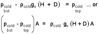

Next the hydrostatic principle is applied to represent the pressure difference of atmospheric air, bottom to top of the system. A constant atmospheric density is assumed. The pressure difference needed above is:
Equation (4): p_cold,bot − ρ_cold g_o (H + D) = p_cold,top … or (p_cold,bot − p_cold,top) A = ρ_cold g_o (H + D) A
(4) 4

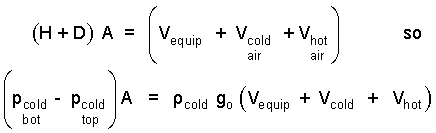

But (H + D) A equals the entire system volume which is the sum of the volumes of its parts. We use this fact to alter the result immediately above:
Equation (5): (H + D) A = (V_equip + V_cold air + V_hot air), so (p_cold,bot − p_cold,top) A = ρ_cold g_o (V_equip + V_cold + V_hot)
(5) 5

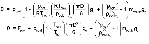

Check the algebra. The density of the cold air is miniscule in comparison the effective density of the equipment. Change (ρV)equip to mequip. Apply the ideal gas equation to express the air densities ( (ρ = p/RT)
Equation (8): 0 = ρ_cold [1 − (p_hot/(RT_hot))(RT_cold/p_cold)] (πD³/6) g_o + (ρ_cold/ρ_equip − 1) m_equip g_o, with ρ_cold/ρ_equip struck out as negligible; 0 = F_sup + ρ_cold (1 − T_cold/T_hot)(πD³/6) g_o + (ρ_cold/ρ_equip − 1) m_equip g_o
(8) 8
